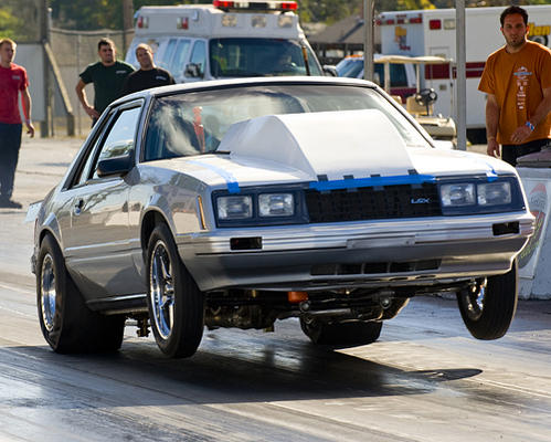

Here's a mustang I mini tubbed and did the rear suspension on. It runs an n/a LSX motor. It cut a 1.19 60 ft. Which we r really happy with.yYes its a 10.5 W tire. Sorry no et . He grudge races it. Now I gotta get it back over here and dzus the front of the hood so he can take off the tape.lol
File comment: Vals mustang

Yes, yes, I really like the rear wheel placement in relationship to the fender. Too often I see them to far toward the center section and looks aweful. I assume it's not stock suspention with that wide a tire. It was a real challenge to get my 29.5 X 10.5 in there on a 12" rim and still have stock suspention.

Yeah Dogg its "stock suspension" but has 1 3/4 c/m lower control arm with 3/4 rod ends , offset inboard like 3/4" at the torque box. With a 12" rim, rearend is narrowed 2" per side. There r some build pics on my webshots site

Yeup sounds about right. We just got mine to work without offsetting at the torque box. Nice work.

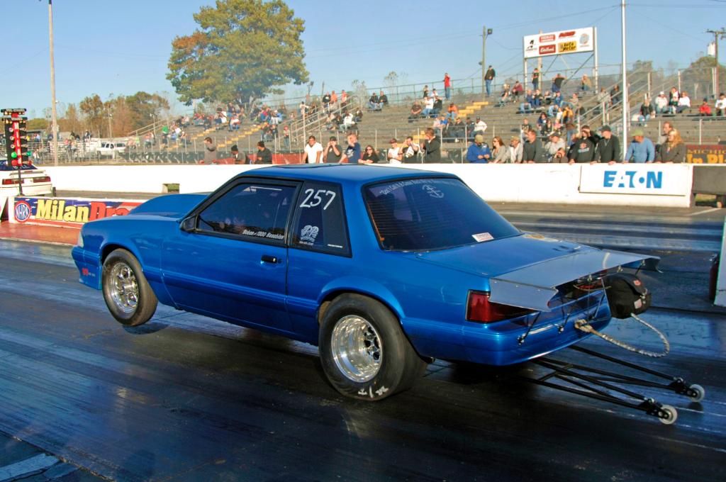

Here's another one I did a while ago,but it has ladder bars
File comment: Bobs mustang

Is that a MidWest wing?
 Post subject: Re: a mustang
PostPosted: Oct Wed 20, 2010 7:39 pm
No they both have skinny kid wings
